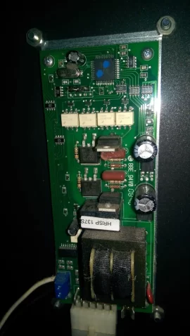

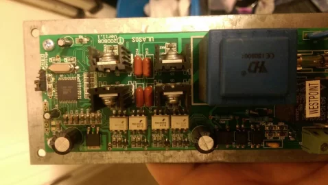

It looks like you have the old board. Below is a pic of my older board and then my newer board. I took a pic of the front of my newer board as well. There is a jumper that dictates what kind of feed rates you are going to get. The jumper can be in three different positions that is why Smokey revered to all of the available heat level settings. It looks like yours is set up correctly, it is at least the same as my original which burned the same as my current board. Your air temp was a little lower than mine but in the ball park. Outside temps, pellets and cleanliness of stove would effect this number but I think it is feeding appropriately for level one. The ignitor stating on is of concern.

I will contact Hudson to see if they would replace the board to the newer version. If it's not a recal what is the ballpark for a new board?

The last I knew the entire line of those stoves was using a single controller (I am aware of at least three versions of the controller that was on my stove) but I haven't paid particular attention to your stove. I will do some searching sometime today.

What feature did the original (my board) not have that it was supposed to?
I can use that information when I call the manufacturer.

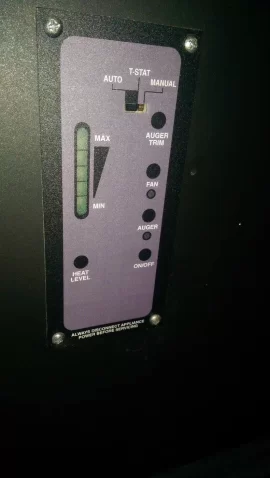

If you look at the face of my control board you will see three settings, manual, auto, and tstat. My original only had two modes. Basically it only ran manual or hi/lo. The upgraded board does both if these plus on/off. Which is an important mode to be able to run in the early Spring and Sept-Dec for me.

I definately want that! I did hook it up to a tstat but just hi/low was pointless. I wanted it to turn itself off at night and on in the morning but found out I couldnt (because of the hi/low).

I can't find any information on that older controller in what I have on my hard drive or online. I thought I had some older copies of the Westpoint manuals and other stuff I can't find. I can find a source for that in Canada under the part number that is in the online Westpoint Manual which is SPSW1008. Maybe my old stuff is on the hard drive in the old computer.
