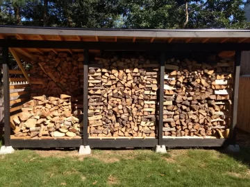

I bit the bullet in one bite. Made it a priority so that I now can relax with a well-earned, and well-burned (-ing) fire. Glad that's done.
I still can't believe your wife is mad about the wood pile, that thing is a work of art, more of a reason to build another one rather then have splits out in the elements.
I, stupidly, broached the subject of building another one. Result - see "stupidly".
I think she has turned around. In fact, that shed looks rather good when it's filled, and with the black paint (shamelessly plagiarized from highbeam). And it's a good backstop for balls (kids, sports)... She'll turn around completely when we light the stove again.
There'll be no new woodshed though, I think, I fear. Have to control my addiction...
But, in fairness, this, with the heatpump, should suffice.
