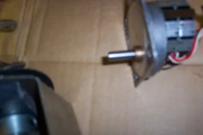

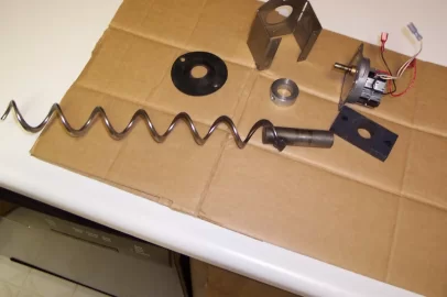

Have a couple more questions after removing the auger. Although it looked clean, I cleaned it good anyway.
Should the spring part turn by hand? Spoke to a quadrafire dealer (2.5 hours away) and they stated it should but mine doesn't. I borrowed my neighbors camera to provide some pics.
The spring turns freely when the nylon bushing and set collar are in place (even attached to the stove), but not with the motor shaft attached. In the 2nd pic, it looks like a brass bushing coming out of the motor but doesn't look like it can be replaced. So my verdict is the auger motor - any other feedback would be greatly appreciated.

If it was mine I would use the auger till it stop working. But I would order one to have it on standby just in case. Unless the noise is unbearable or the stove does not function properly I would not replace it.
