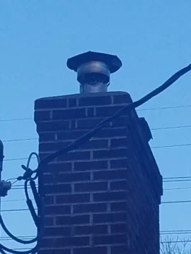

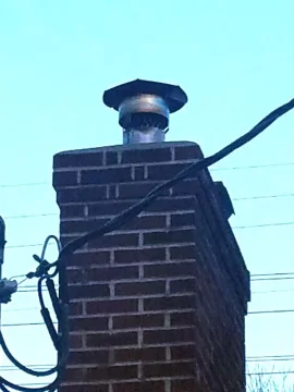

If it wasn't it sure looks like it is now.Looks like an old cap. Was a previous cap there recycled? Is the cap galvanized?
It just looks like some rust due to wet weather and a hot stove as long as it's still there I wouldn't frettomorrow will be a full week that I'm burning my voyageur Grand. should my cap on my pipe look like this. thank for your replys

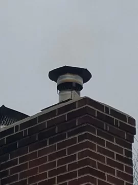

It's a brand new cap and I thought it was stainless steel

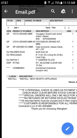

It's a brand new cap and I thought it was stainless steel. I've only burned it for a week so far. Attached are the installation Parts the installer used. Could you guys tell me if it's stainless steel or galvanized. Also another picture from a different angle. Thank you again for all your input . View attachment 2226155

Same cap I have on my liner. Absolutely guaranteed to be stainless.This shot is a bit better. I color corrected and lightened the image to see it better and agree with Webby3650 that it looks normal and like stainless from this angle.
