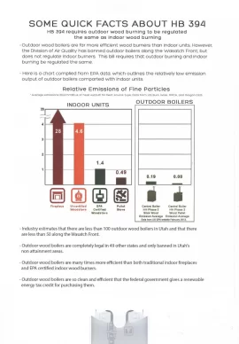

An intense fight is going on in Utah, where a boiler manufacturer is making case that outdoor boilers are cleaner and more efficient than wood stoves, so they shouldn't be regulated any differently. In my opinion, even Phase 2 qualified outdoor boilers should not be allowed in valleys that experience lots of inversions and are in air quality non-attainment. There is simply too much potential for them to be operated poorly by the owner. Industry fought so hard to clean up the air in places like Libby, and this sort of precedent could be big set-back for valleys like that. We posted some stuff on our blog about it
http://forgreenheat.blogspot.com/2013/03/outdoor-boilers-cleaner-than-wood.html, but interested to hear what folks think about it. Check out attached "fact" sheet that is being circulated in Utah.

FIRST: The flyer shows emissions per mmBTU. When you are in an area that is subject to inversions and particulate contamination the reference point has to be emissions per hour. During the course of an inversion the OWB will put more particulate into the air than a wood stove.
SECOND: Most people that use OWBs use so much wood they do not have time to season it. If they burned it cleanly it would be much less of a problem. I know of only one person that considers his neighbors when he burns his OWB. He uses seasoned wood, has a tall stack, large storage, and when weather conditions are not right (he is in a valley in Vermont) he goes to his fossil fuel backup. If there were some way of making ALL wood burners, including indoor stove users, use their equipment properly this discussion probably never would have come up.
THIRD: If you search the news for articles on outside wood burners you will find a number of communities that are considering banning them. Some pro-actively based on the bad press a few OWB users have generated (See the recent Fairbanks stories)
As I said in another thread before it was moved to the ash can: I don't think a ban on OWBs or any bio-mass heaters is the way to go. Clean them up and develop some method of accurately measuring the individual users' compliance with emission standards. Yes, it adds a new layer of government rules and regulations but the days of throwing tons of green wood in a steel box with a 6' stack are numbered. If the users are not considerate of their neighbors then the government, elected by the majority, will step in.

As Kapt Jaq already caught, the statistcs used in that graph are misleading. Plot emissions per hour, or even a more useful emmissions per BTU's delivered (not BTU's consumed), and OWB's will be much higher on that curve.

Now, go back to the OP, which uses twisted statistics to imply that OWB's have lower emissions than EPA woodstoves and pellet stoves...
Exactly!! When you think about it, it's no wonder the manufacfurers like CB, Heatmor, and all the rest are fighting so hard to keep the laws skewed in their favor. There is no way to make their basic design and operational premise burn clean. You simply can't stuff a huge firebox full of wood and let it smolder/burn/smolder/burn/smolder etc. etc. ad infinitum, ad nauseum. If they changed to a burn program that actually burned clean out in the real world they would destroy their main selling point of convenience (load it once a day/burn green wood)
So they mess with the test protocol as much as possible so the results are slanted toward their method of operation.
Why don't they just start building stuff that functions right? One has to think the money is good where they are at or else they don't have the engineering skills to pull it off.
