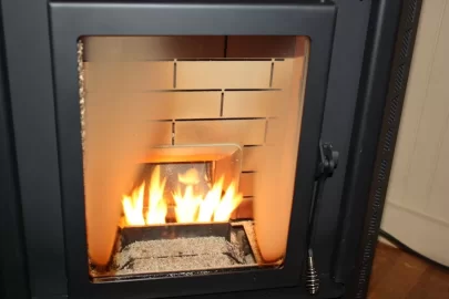

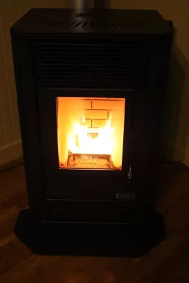

should stove glass look like this?

Looks to me like you could use some more air ..........
It happens if your stove spends time on low.
It looks like it could use more air, but with that said as long as it's not sooty black streaking it'll be fine. Grey/brown ash on the glass is normal.
What kind of pellets are you burning? I found a pretty wide spectrum of how quickly my glass got dirty with the quality of pellets I burned.
Reactions: Ctcarl
Inside stove looks good, Flame looks about right. I think you are fairly close on the settings.
If you don't mind what are u burning for pellets?

Thanks for replies. I am using LA CRETE pellets. The ash is light, and not black. They burn beautifully compared to my 1st (forgot name) bag from Lowes. LA CRETE are softwood, I read many reviews recommending hardwood. I adjusted air slightly, hopefully will help. I burn on high for 1st hour, then turn down to mid range. Am hooking up to thermostat next week, which will make unit run automatically, which is why I would like AIR/PELLET feed rate settings to be as good as possible.
La Crete is a good pellet.
I think you will find that some ash trailing on the glass is perfectly normal. It just wipes off with a dry paper towel or a dry rag when the stove is hot ( damp when cold, damp rags and hot glass don't mix ).. I do this when I scrape the pot sometimes if I feel like it. I wipe it off with a damp paper towel when cold. It wipes right off, basically just dust.
My harman p35i does that same.as mentioned above.as long as not thick black and hard to clean off your fine.i just hit mine with 2 pieces of a damp paper towel (cold only)on my 7 day cleanings.
