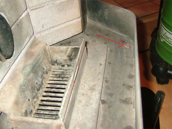

Cleaning the stove today i noticed this small gob of goo so i scraped it out to reveal a small hole about 1/16 dia that has been drilled. Should it be there, what would its purpose be, why would it be plugged?
[Hearth.com] Should This Hole Be Here?
mine has an 1/8 hole drilled out as do a lot of other stoves.in my case its for setting the draft with a magna gauge.hopefully someone with the same stove will chime in soon
Looks like little spot welds? Does the stove burn any different? Lots of little welds in the front of the unit?
If the goop was plugging an unnecessary hole, then I would fill back in.
A Whitefield owner should be along soon. I don't see it being for a Mag gauge on an older stove. Possible for vac switch? If applicable?
