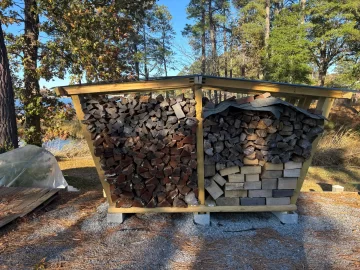

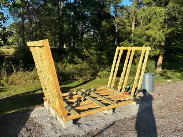

Nothin square or plumb about this. But a trapezoid shape seems to work.
If u have those rafters tied together then u should be good. If not those walls will probably be pushed over by the stacks as they settle. The 2x4's in the blocks are prone to rolling the blocks with the 2x4s levering them over with the pressure of the stacks.
Ask me how i know!
The Left block looks like it's already starting to roll. Just add some collar ties or blocking to fasten the right and left side rafters together.
Thought about the eventual outward push by the wood settling. I loaded the wood first. Let it sit for a few weeks before attaching what you are charitably calling "rafters" Lol.
I've got the 'rafters' connected to the center post, but good idea on the collar ties.
I think the blocks are pretty stable. No rolling detected. Enough weight downward to counteract the inward push at the base of the 2x4s. Although it is an interesting question: How far out on the wings could you theoretically go before the lateral forces overcome the downward force. I'm sure there is an engineer out there who could supply a formula, but I'm using eyeball math. If it rolls, I'll post the result. Lol.
Reactions: Burnin Since 1991
I used to think that as well. The 2X4's on top of the blocks don't put nearly enough pressure on the blocks to stop them from rolling. What happens is the walls creep further and further slowly over time. The problem is you can't push them back without taking all the wood off them.

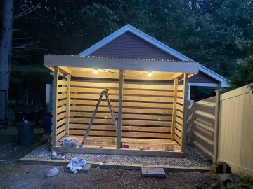

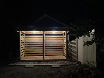

Love the Lights.
It looks sad... and empty. Without wood, it's just a shed 😁 :ZZZ 🎄

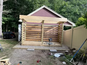

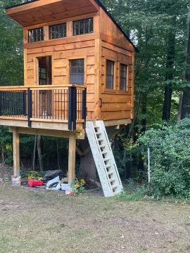

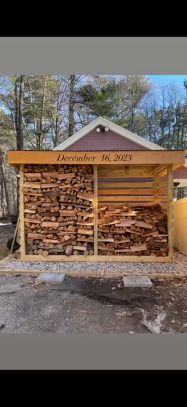

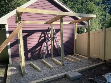

This was from 2023. Wide would periodically take pictures so we knew how much we were going through. I love working on these types of projects. Not a wood shed, but this is my crown jewel of builds. Figured people here may like it.
  • [Hearth.com] Show Us Your Wood Shed
Very nice shed! You did a great job on both! I have a folder on my computer for future projects. Your pictures are in there!

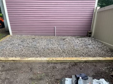

I just started the build for my firewood racks. I cannot have an actual structure due to HOA rules. Spread 2-tons of 1" clean gravel over 200 sq ft. ~ 6.5' x 30'. I have supplies to build 2-racks this weekend, hold a standard 1/3 cord. I should have enough room for 3 cords, This is all for the install of a ZC Osburn later this year, burn in the fall. I've got access to some dry wood now, already tested for moisture, and will be able cut my own. One rack of wood I have is too wet and will have to sit a couple of years.
It would be more believable with pictures... But I guess there's no racks yet...
