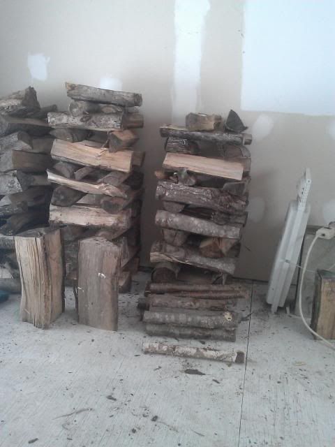

Sounds like you are doing things right and the chimney is not too tall. She's just a willing puppy. Try cutting thicker splits for future burning. And post a picture if you get a chance. We love to see stoves with fire in their belly.
You make a good point about splits . The wood I had for this season was all cut as "cook stove" wood . Mostly around 3-5" splits . Did try a few of my rock maple splits that I had done which are 8-10" . They did burn cooler and longer . Luckily , next years stash is what I personally split and is a good chunk bigger splits . Only problem is they are all cut to long for NS burning.
Barring unforeseen circumstances , I will be running this stove for a long time , so I will be cutting future wood to be able to burn NS . Even though EW has worked OK , much rather burn the other way for loading ease .
Here is some of the last of this years pile with a couple splits from my maple standind beside it . Big difference in size . So your probably right about split size making a difference in burning .

Had to dig this stuff out of a snow bank since my tin blew away and had a few snowstorms after . Just stacked it up and used a fan to get the surface moisture off of it . Stuff practically bursts into flames within 30 seconds of hitting coals .
We're burning splits like the leftmost one standing on end. Locust mostly right now. They go for 10-12 hrs., it's almost like burning coal.
