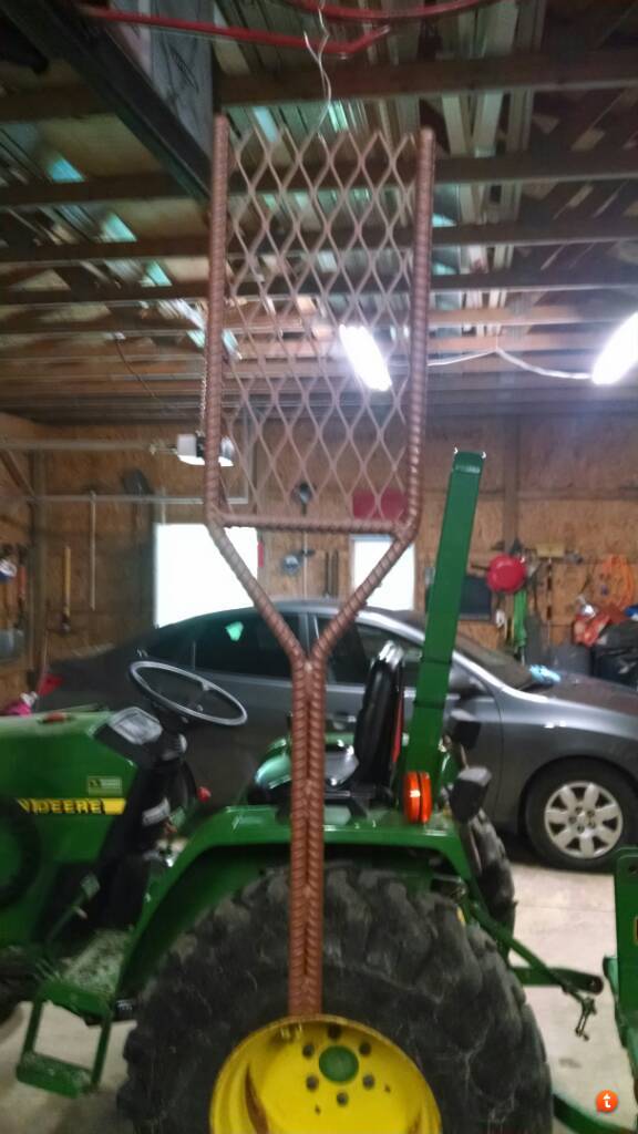

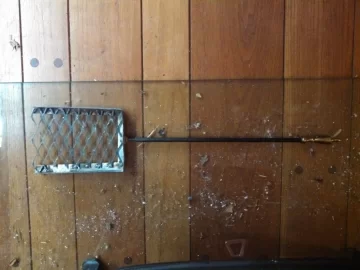

I fashioned a scoop from an old scrap piece of expanded metal, I bolted it to a handle made from an old towel rack. It's just like an ash shovel, but mostly holes. No mess, no fuss, and it works well. The Mark II model will have a heat shield like a sword guard.

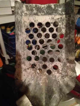

I bought a flimsy metal shovel (that looks exactly like the coal keeper) and drilled a bunch of holes in it. I put a metal loaf pan in the stove, and then shake the ash through the shovel into that. keeps the coals in the stove. Before that we used a slotted metal spoon we got from target. Look around at hardware and home improvement stores, see what you can come up with. I wouldn't try a fryer basket, they seem a little big (at least for my stove).

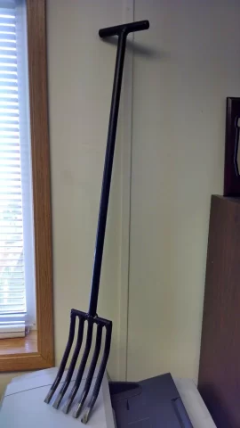

100% Stainless Steel. I built this as a prototype. Works great and I will try to convince production we shuld build them.
  • [Hearth.com] Sifting Through Stove ash to retain chunks of wood/charcoal- ?
Looks like it's the "King-model"; will there also be one for us mortal stove owners? ;)
I do need to shorten the handle so a hook will permit it to hang on the back of the stove. I also think the 1/2" spacing could be a bit wider between each prong.
