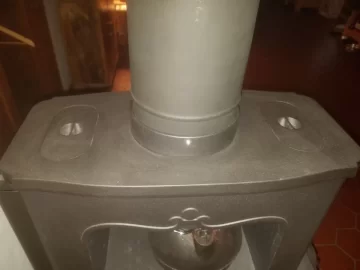

Here's a photo of my flue collar. Are you saying I can get a damper that can fit the flue collar?

If so, that would be perfect.
Thank you.
I recommend you ask @bholler. the one i use is the same brand of my stove pipe. I have on one setup the adapter and a key damper on my other setup on the pipe. I do like better the one on the pipe.
It usually works better if the damper is 12" or so from the stove. But with your stove it may not matter as much
Do you think a damper would be beneficial for my install? I wish this stove had an adjustable secondary intake to compensate for the tall chimney.
If you are already running that cool on the surface of your pipe probably not.

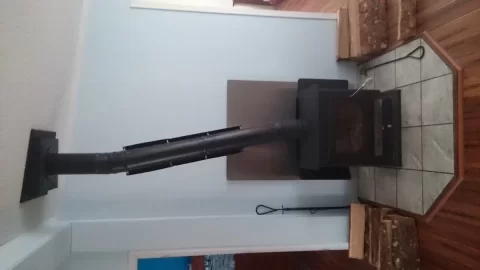

The chimney is double wall, duravent double wall, stainless, with screened(?) cap, also stainless. Ceiling box is duravent triple wall/insulated.
Stove is Englander nc-13. At the chimney ceiling box, the pipe is 18.5" or 19" from the wall. Tapers back to about 16" or 17" down at the stove. Instead of running an extra wide or angled wall shield up, I took 8" pipe, split it, and mounted it over the 6" pipe, on the back 180 degrees. I used the same ceramic spacers used for wall shields.
Wall behind will get warm, but not hot.
I added the little side shields because the walls on either side got hot enough I didn't much care for it. You could leave your hand on it, but it was pretty hot.
The pipe is angled because the roof above has a peak which goes back, and putting the box where it is avoided having to mess with that.
Well, I could run it hotter, but I feel like it might damage the stove. At the hottest part it will run up over 700 in a hurry if I chase flue temps.
I own a duravent double wall damper equipped appliance adapter. It's the first little 6" chunk of pipe you stick into the stove, comes with a key damper installed or without, and then you drop additional sections of double wall pipe right into it. Some stoves need an appliance adapter and some don't.
If the surface temperature of a piece of single wall is 200 when the stove below is over 700 then I suspect that you have a broken thermometer. Or, since 200 celsius equals almost 400 Fahrenheit you might be reading celsius. 400 would be about right for a 700+ stove.
His stove is a 2 tiered moroso. They do a very good job of extracting heat from the fluegases. In my opinion to good of a job
