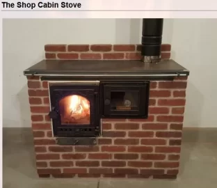

I'm trying to imagine what your masonry heater/stove looks like. You say the pipe comes out of the top. Is it like this?

Low-efficiency stove answer: You only need double-wall if your clearances require it. Flue gasses will be hot enough that the performance differences between the two are not a factor.
High-efficiency stove answer: Double-wall pipe will help keep your already-cool flue gasses warmer, provide maximum draft, and help to prevent the condensation of creosote in your chimney. The number one complaint of folks switching from old pre-EPA stoves to modern efficient stoves is that their draft is lacking, so do not ignore this factor.
