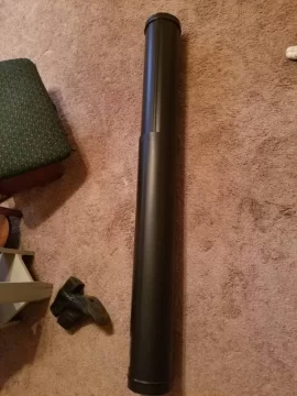

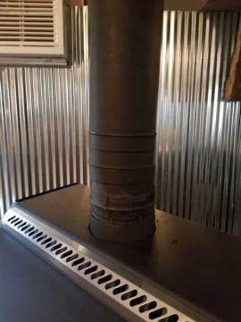

first 2 pictures are what I currently have and the last one is the telescope pipe I'm changing to.

Looks like multiple 6" pieces on the bottom. Slice through and sacrifice the stove adapter just above the flue collar on the stove.
that's right did that to make it fit. with the new telescope pipe not need the adapter? and fit right in the stove collar?

Yes the top slides right in. Why not put the collar on?! It helps the pipe not slide out while you drill and place the three screws below.
And it would be best to leave out all that bottom non sense unless the pipe isn't long enough. But I saw no dimensions of anything.
One of those should have been you’re single wall adaptor that went at the top.
