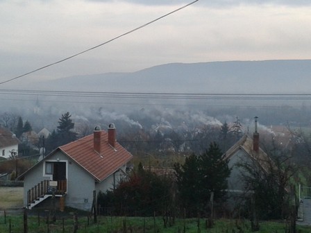

When we remolded, I had both our simple brick chimneys removed and put in fully insulated commerical new ones (they are actually insulated ceramic flues). Even though I was not required to do that at the time. Yes, the short pipe from our stove is still single walled for now but only because no one here sells double walled steel pipes in the correct sizes for the output of our stoves. But even so, the emission reduction was impressive. Especially compared to everyone else near me with the old brick chimneys:
Oddly, 10 years after I did this, the laws changed, and what I did is now required for new construction.
