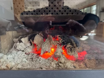

Ok, So I started a fire last night. This morning, I loaded the stove, and :
-let the cat get to active before closing the bypass
-I waited about 25 min before started turning the stove down
-turned the stove down in 3 10-15 min increments.
Still got some smoke.
I then turned the stove back up a bit, and the smoke disappeared. Should I assume this is the sweet spot for my particular install? Would extending the chimney a foot or so make much of a difference and enhance the stove's performance?

And does it still smoke 2 hrs after that?
And does the cat stay active for hours after that (assuming it was a full load)?
With low flow (15' chimney and dialed down), residence time of the gases in the cat is large. It should be effective.
If it keeps smoking two hours after this, it's not working well.
I would expect it to drop out of the active range sooner than normal too.
I suggest getting a new cat. Put that in, see if all is well. If so your current one may be dying.
If not, it's another issue and you just have a spare cat in the shelf for when one dies. (Not if, when.)

@stoveliker, I just want to let you know I appreciate the attention you are giving this issue. At 8:30 eastern, we had the smoke when turned down. 3 hrs later it's still active albeit is getting close to dropping to inactive. Not much smoke at the 2 hr mark.
Also, the logs are pretty burnt down, I didn't pack the stove, so that's also why it could be dropping out of active? I have attached a pic.
Would adding a foot or so extension make a difference for me?
I really can't imagine the cat being dead. As stated its a weekend cabin, and we aren't here every weekend maybe every other week or every two weeks. I'm not putting that many hrs on it.
