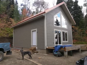

Hello, I'm looking for a recommendation for a wood stove for my cabin I am building. It's off grid, in the mountains above Mt Pleasant, UT. Sits at about 8000' elevation. The cabin is 22'x30' with a 22'x15' open loft. The stove will sit almost directly in the center of the cabin. The chimney will be straight up to the 19' ceiling and another ~5' through the roof. I'm expecting to need to use double wall pipe to retain enough heat in the pipe. Correct? I want a stove that can make it through the night but not too big that we'll be cooking ourselves out. I'm thinking Lopi Answer size but I'm not sure.

If there is no other heat source that means you will be heating the cabin and it's contents up from cold. Because of that you need to go pretty large. Possibly a large cat stove which can be run hard to bring the place up to temp then once everything is heated up you can shut it back pretty low.

I would go closer to 3 cu ft. It takes a ton of BTUs to heat a space up from cold. How long will you be there at a time?
How well insulated is the cabin? Does it have any other form of heating? If the place is tight and has good insulation then a 2 cu ft stove may handle it. But if you are just going there on weekends then I would consider an alternate form of heating to maintain the place well above freezing to protect water pipes. With a smart thermostat you could even start the place warming up before you get there.
The heat will want to pocket at the roof peak, making the loft area a lot warmer. A ceiling fan will help circulate the heat. Run it in reverse in the winter. As a new woodburner know that the #1 thing that will make it easier is having dry, fully seasoned firewood. Build a good shed and stock it up with split wood now.

During winter months we will probably only be there a week here and there. It's snowmobile only in the winter. Spring and fall we may be there for weekends and full weeks occasionally.
It will be well insulated. It's all being built to code. We are toying with getting it all spray foam right now.
We won't have water in the winter. So pipes will be drained. Also no electricity, so no smart thermostats. I did pick up a small propane wall heater to supplement.
We will have ceiling fans, one in the loft and one over the great room.
With excellent insulation, a radiant 2 cu ft stove will handle it. A 3 cu ft stove will too and it will have more reserve power, but this is not a large cabin, so during fall and spring you could find yourself leaving windows open. Your call. Either go for a 2 cu ft stove and plan on supplementing it with a decent propane heater in the dead of winter until the place warms up or go large and run the stove on partial loads in milder weather.
