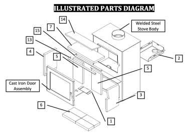

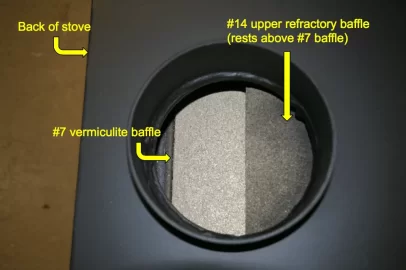

I have started burning in a recently installed Englander 17-VL. Once ignited, I am largely pleased with it. However, getting to the full burn stage is a challenge, and what works great on my Woodstock Keystone downstairs is pretty much a hassle on the VL.
I use Super Cedars (two quarters in the KS, two halves in the VL), put largish splits on the bottom, use oak splits, larger oak kindling, and thinner pine kindling around the Super Cedars on top of the large splits. In the Keystone, I ignite the Super Cedar chunks, leave the air control at 4, and I'm set. I then turn the air control down to 2 or so, and the load burns until the temp is sufficient to add more splits and engage the cat. My firewood has seasoned for a couple of years at the least, and none of the splits are crazy big.
In the VL, I follow the same process, but even if I leave the door open to get everything ignited, when I close and latch the door, much of the fire goes out and what's left is dark yellow/blue flames that are tentative at best. Copious smoke, too. And after it burns out, it leaves much larger chunks of charcoal (?).
Is the primary air source on the VL smaller than on the VL? Even wide open it seems stingy.
Is chimney height an issue? The Keystone pipe is twenty or so feet and mostly through two floors of indoor space, the VL is 14+ feet on a chilly sunporch--half of the chimney is outside of the house.
I realize the installs and stoves are quite different, but what might I do to make the process of starting fires in the VL a little more successful?
