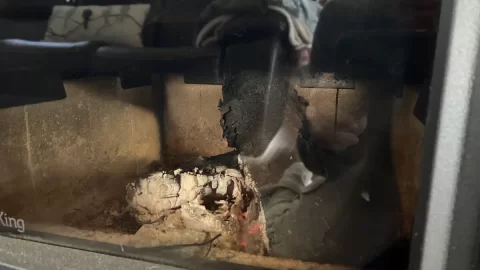

Hey guys I'm back for a 1 year on the BK ashford 20 and have good and bad news. Good news is that it heats the house very well and 12 to 14 hr burn times. Bad news is my cat is already falling apart. No idea what's going on anyone have info? I burn maple, beach and cherry.

I thought moisture was best checked by re-splitting and testing the long side? Maybe I'm wrong, but I think you might be seeing artificially low moisture #s by checking end grain, guessing the middle of your splits is higher.....
No idea on the cat...

Good to hear the stove is working out. Perhaps @BKVP can advise on the Cat deforming.
No offense but your moisture testing is inaccurate. Take a selection of your splits indoors for a day or two to get them up to room temp. Split them again and test the freshly exposed interior face. Let us know what you find out. Got any pics of your install?

Quick question's. Are you burning real small loads as pictured, normally, or loading it completely full for a long batch burn? Your stove looks like brand new inside! The glass is clean like it's burning with active flame often (unless you just cleaned it?). Are you reloading when the Cat gauge gets down to inactive or close to it? Mostly just curious what your routine is.
Sooo? You just now split the wood fresh for the test with the wood up to room temp? If so, your good and dry.
I load big at night and before work, when I get home I'll just throw a few on to make it till bed time. I keep the glass clean and I clean the stove once a month. only reload if needle is getting low.

Sounds great and I wouldn’t change a thing. That cat falling apart is weird and I’ve never seen it but I don’t see any reason to worry about it. The cat is a consumable item and you’ll be getting a new one anyway so I would just wait for it to wear out. I don’t think you caused it or that it will happen on your next one.
At some point in the past year was any of the wood frozen, icy or snow covered?
