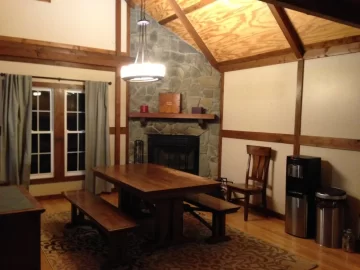

I've read the "read before you post links" so a lot of these details are based on those primers. I've visited at least 15 mfr websites, read EPA reports, and crunched numbers off and on for months. Well, it's getting cold and its time to decide if this year is possible or if I gotta save my pennies til next year.
I'm having a real hard time getting retailers to call me back, when they do, I seem to know options better than they do (which is scary since I feel lost), and when I went to a showroom today, they had nothing close to what I'm interested in (options wise... I can't even find enough choices to actually price shop!). Help!?!... is there actually a product out there that fits my list?
I would like to spend a total of ~$3000. Based on initial estimates, $1000 of that is going to installation.
I like clean, simple (contemporary) lines. I don’t want arches or anything fancy. A nice square, black box as flush as possible is my preference. I Love the look of the Regency Alterra CI1250 or Osburn Matrix (too big) but I really want a catalytic insert with lower emissions (ideal under 1 gm/hr but up to 2 will be considered). I prefer steel for lowest maintenance but cast iron is ok. I would like the largest fireview possible within these other guidelines.
I plan to burn seasoned hardwood as needed in late fall/early spring and 24/7 for the winter (central NC). Climate history suggests lows from high 20’s - low 30’s during the winter months. We prefer a warmer house around 70-72 and overnights will necessitate a min burntime of 8 hours.

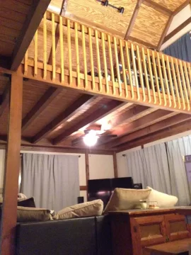

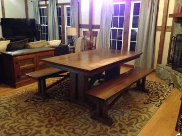

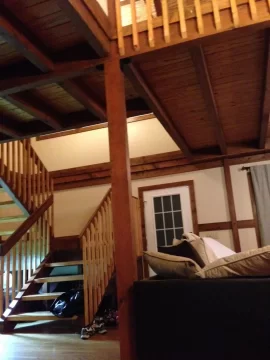

The house is a 2-story, cape cod style, timber-built home with rough sawn wood siding, metal roof, moderate insulation overall and approx 1750 sq ft. Open beam plan - dining, family, and kitchen combined (750 sq ft + 120 sq ft loft) w/ adjacent master bedroom on 1st floor. 2nd floor loft is just above the fireplace (in the dining area) and 2 upstairs bedrooms are above the kitchen area / master bedroom.
My biggest problems seem to be:
- I want very low emissions
- I want a thermostatic controlled variable-speed blower

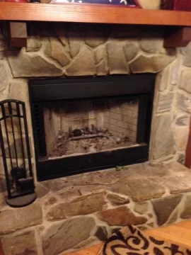

- My stone fireplace has weird dimensions: 32h x 40w x 17d
- My budget is small
Here are some images of the space but the kitchen is open and attached as well :) Any suggestions on the best fit or models to check out would be greatly appreciated. I'm exhausted and still have no idea what to buy.

You have a few musts that are making this difficult. Small flush, super low emissions, overnight burns, and a small budget don't usually go together very well.
We do the Lopi 1750 with telescoping legs out front in setups like your pretty often. Its a little cheaper and can handle overnight burns, but it's not flush at all.
If you are choosing the cat stove for its apparently lower emissions, I believe those are for a new catalytic converter and the regs for having them lower was to have their average emissions over the cats lifetime still be below the overall EPA goals for newer stoves. They degrade with use which results in trending higher emissions over time.
Have you considered placing the stove in front of the fireplace?
A year ago I was leaning insert, but became convinced it was a poor choose for me (external masonry chimney would be a large heat loss, inserts radiate less heat than free standing stoves, inserts depend on blowers to move heated air but we have had very long power outages over past winters, several more than one week, plus I didn't want the noise) and now have a free standing stove located in front of the fireplace.
So far anyway, I am convinced this was the right choice.

I also looked at the pictures and suspect what you have is not a masonry but a prefab zero clearance fireplace. What kind of chimney do you have? Is it a round steel flue going up in a wooden chase?
Putting an insert in such a fireplace is a bit tricky as most fireplace manufacturers don't allow the installation of an insert. However, several inserts have in their UL listing that the insert can be installed in ZC fireplace. It is a grey area and your local code authority and home insurance may be ok with an insert or not. It is certainly a good idea to ask them first before proceeding.

I think that 17" depth and flush does leave you with few choices (and smaller fireboxes, make it hard for 8hr burn). That is very similar dimensions to mine but just a tiny bit smaller. I bought the biggest insert I could fit that I liked, the Rockland, and it needs 18" depth and pretty much touches on the corners in my fireplace. Its flush though, but wide, so still has a large capacity and could get 8hrs if fully packed with good wood. Its steel (has cast iron trim though) and available with a plain surround if you prefer that. You sure you can't squeeze one more inch in there? Not catalytic and probably too expensive though. Hopefully some others will be aware of something that might fit your criteria.
I don't think you can get there from here. The Hampton HI300 requires 17.5" deep, is non-cat and will definitely be too expensive since my HI200 (which will definitely fit) was $3500 installed with insulated liner. You might also check out the Quad 2700i. It will also exceed budget but it has a .4 ft3 larger firebox. At 17-1/4" depth may be able to squeeze in there if you have a big hammer.
Take a look at the EcoChoice WINS18. It has a very contemporary look, no curves or arches and a very large viewing glass. It is also very reasonably priced at or around $1800. It has a nice sized firebox at 2cuft. The WINS18 also comes with the thermostatic blower that you desire, as standard equipment. It will fit perfectly in the dimensions you are dealing with.
Now, what it doesn't have is a cat. Its emissions output is 2.6. And it is not a totally flush mount, but it doesn't protrude very far.
I had similar requirements as you when I was searching a few years ago. Had to have a contemporary look, large glass, and reasonably priced. The look and size alone won me over, the price was just a bonus. It has been a fantastic stove. You should give it some consideration, I think you will like it.
http://www.heatilatorecochoice.com/products/details.asp?cat=wood-inserts&f=WINS18
