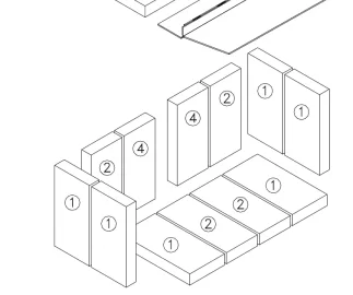

The Osburn 1800i firebox is only one firebrick deep or a bit over 9" unless you load the wood on the ledge in the bay area. It's mostly an E/W loader.
[Hearth.com] Small fire box short burn times what to do?
The firebox is only about 18" wide. I haven't run this stove so to be fair it may be possible to load 16" splits set N/S in the middle where the bay bows out. Not sure about the sides though, maybe 14" would work there?
