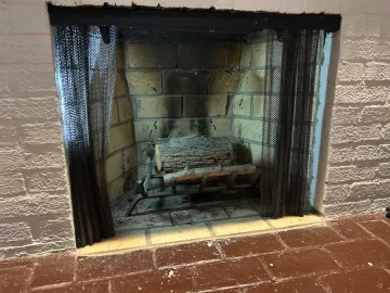

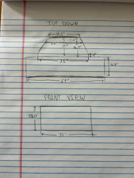

Hey all,
Long time lurker first time poster. I recently moved to a new (old circa 1918) house with a masonry fireplace. Of course, I want to install a wood stove insert. Unfortunately, my fireplace company told me that there isn’t an insert that will fit my fireplace. So, I came here for a second opinion. I am attaching the measurements I took. One area of concern from the company is that there is slight concave on the back wall of the stove. The fireplace has a height of 18” at 18” depth.
I hope someobody here is aware of something that can fit. Please let me know if any additional measurements or images would be helpful.

There is no hard rule that an insert has to have a surround face. Some can be installed without it and look fine as long as the fireplace doesn't have a deep lintel that partially blocks the flue exit on the insert.
This looks like a solvable issue. Can you post a picture of the whole fireplace area for sighting of other potential issues?
Are you looking for a budget insert or one of a particular style? How large of an area would the insert be heating? Is this room or area open to the rest of the house or closed off by doorways?
For starters, look at the Osburn 1700-i insert. It's depth is adjustable so that only about 13" is inside the fireplace.

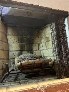

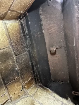

Thanks begreen. I attached some images. If there’s another angle that may be helpful, let me know.
At my last house I had a freestanding BlazeKing Ashford that I liked. I enjoyed the low slow burns and aesthetics. I don’t necessarily need another BlazeKing, or even a catalytic type stove again, but I would like something that I can get overnight burns with and ideally be able to adjust the heat output.
The fireplace is on the first floor of a three story house. The house is about 2000sqft total and around 750sqft on the first floor. The first floor is pretty open but with doors that lead to the entry way and up the steps. I have multi zone hydronic baseboard heating. But I like the heat output from wood stoves and have a decent supplier of wood.

It looks like the True North TN20i might just fit in there also. It would have the advantage of being a N/S loading stove. This could be installed without the surround if too tight.
The Regency i-2450 might fit with some grinding down of the back side bricks an inch.
Thanks begreen and DBoon. I checked out the various stoves. Between the Osburn 1700, Lopi Answer, True North TN20, and Regency I-2450, the True North and Regency caught my eye for their larger volume and ability to hold longer cuts of wood. However, I don’t think the Regency will fit width wise towards the back of the stove.

I believe that it could fit, but would have trouble with the front clearance. I would probably have to modify my hearth and wood floor to make it work, and my hearth is already at a slight angle downward.
I had my chimney sweep come and he recommended the osburn inspire after some brick grinding to make it fit. It seems very similar to the osburn matrix, but not sure if the lack of handle on the inspire will get annoying.
