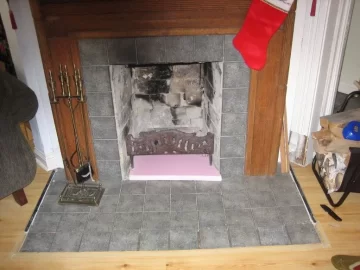

I wanted to follow-up on a previous post about finding the right option for a very small firebox (23"WX30"HX13"D) in an old home (1892). I was considering extending the hearth out into the room another 25" or so and putting a woodstove on it. The problem is the wife doesn't like the amount of room it would take up. So we contacted a mason to see about modifying the firebox to accomidate a larger insert. He said we have two option and both will cost around the same ($7500).
1. Put in a masonry heater with a heat exchanger for hot water. The house is around 2000 sq ft. Any idea if a masonry heater would heat the whole house along with the hot water?
2. Modify the firebox and mantle to accomidate a larger insert. After the chimney liner, firebox modification, and insert it would be about the same as the masonry heater.
A last, more cost effective, option would be to put in a small insert (Regency I1100) (would still need to do some small firebox modifications myself) or a small stove VC Aspen and only use it for supplimental heat. Although I was hoping to some day have the option to heat the whole house, but if that is my only option then so be it.
Last question, if we decide on a masonry heater, wood stove, or insert in the living area will the basement get really cold? We have hot water baseboard heat right now and would hate to have pipes freeze downstairs. Any suggestions or thoughts would be great. Thanks again for all your suggestions.

Did you discuss and look at the Jotul F3CB? It looks like it will be a close fit, but with rear-exit flue I think it might make it. The F3CB is listed as 22 3/4" wide so it would be good to check the exact measurements of the stove at a store and recheck the fireplace width for exact measurement. There's also the Morso 7110 at 22.6" wide.

The problem with the F3 is that I would only be able to stick it into the firebox about 1 inch because the width tapers back to a width of 18". In this case I would need to expand the hearth since I would only have 10" of clearance in the front of the stove. Here is a link to masonry heaters: Masonry Heaters
Is it advisable to use a hammer to remove bricks from the firebox and move them 1.5" on each side in order to accomidate the Regency I1100?
From the sounds of it I will have settle for supplimentary heat instead of whole house heat without paying large amounts of money. If I do that the payback period is going to be pretty long...

Extreme caution is needed when attempting to remove bricks from an existing fireplace. In general, the Codes frown on modifying an existing fireplace as removing bricks may result in the remaining structure not offering the required masonry thickness needed to protect adjacent combustibles.
