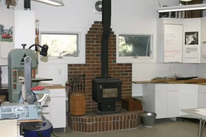

Not exactly, but I have a small EPA-rated Century stove in my workshop which I like very much. I'd shy away from that cast Vogelzang because of their reputation and because of the minimum required clearances to combustibles. Absent any sort of shielding, I think that stove has to be 36" away from the nearest combustible material...that's a big footprint for a little stove. Rick
