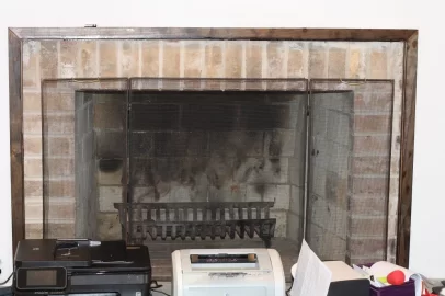

I did the quadrafire 5100i install with a buddy of mine. Took a total of about 8 hours spread over a few days and everything went fine. I have a thread about it out in the forums on it that I have been updating for the past 2 years. I will do the install on this one as well with a complete ss liner. I ask about the plates in the back for a free standing stove...on my quad, the bricks in the fireplace can be touched without an issue when fired...all the heat really comes into the room. My heat gun says that the bricks in the back of the insert are about 90 degrees when fully fired and on the sides toward the front only get as high as 140f. The fireplace I would be installing this in is the same exact fireplace as what my quad is in other than instead of bricks going all the way to the ceiling of a vaulted room, it only has 1 brick length around the whole face of the fireplace and drywall...see the picture please.

do a google image search of "wood stove in fireplace" I just did it for some customers, plenty of pics. A wood stove completely inside is fine as long as clearances are kept. I'm wondering about that wood trim. How far out does it stick from the wall?

The wood trim sticks out about an inch from the wall...it's just a thin trim piece. I can always change it or do something else with it I suppose if it were to be a problem. For the Pacific Energy Neo 1.6 insert, it would not have to be modified as the clearances are met.

If the stove is flush with the fireplace opening and the trim is proud by just an inch I think you'll be fine. If 4-6 hr burn times are ok a Jotul F3CB or Hampton H200 could do the job. If you want a longer burntime go up to the medium sized Jotul F400, Hearthstone Shelburne, or Morso 2110.

Clearances in the manual are given to combustibles. You can check/estimate how much distance you have from the stove to the studs in the walls on either side. Those will probably be your closest combustibles. With a solid masonry chimney above, ceiling clearance won't matter. The only caveat there may be your wooden trim if the stove is not fully recessed. Overall, there is probably not much to worry about.
