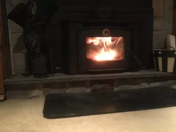

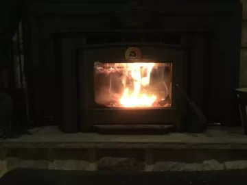

Here are a few pictures of the insert after it's been burning for 1 hour and the air is closed completely. How does it look?

Lively.

That smell sounds like the fire is too hot. IMHO the photo looks like the fire is too hot also.
Could be that the stove is just getting up to that temp and dust is being burned off. The IR thermometer will help determine actual temps.
In that picture the air has been closed completely for almost an hour, I don't know how to control the fire other than the air I am up though for any suggestions

The fire looks fully engaged, much like that in my avatar pic. To reduce large wood gas blooms burn down the coals before reloading. To burn them down I put on a couple small 1-2" branches on top of the coals and open up the air at least 50%.
