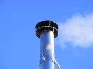

The white smoke is the moisture you will see that has been gased off your wood. This pic is at -52C. Yes that is icicles on the
edge of the cap. No smoke though!!!

north of 60 said:
...This pic is at -52C...
45 minutes later, all molecular motion ceased for a time. :ahhh: Rick
