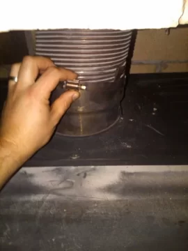

Ok... I found the problem... Pipe on the top of the stove was barely connected, there was a slight slit where the fitting enters the stove because the fitting was in at an angle. Question is, is this fitting the correct fitting to use because what holds it into the top of the stove? There is obviously the hose clamp that holds the fitting to the flex pipe but only the pressure holds the fitting into the top of the stove... Problem is that the top hole of the stove does not line up perfectly with the chimney, the stove has to sit out into the room a little for the faceplate to line up with the mounting bolt otherwise if i push the stove back further the faceplate will sit right on top of the stove with no gap and then blocks the place where the air blows out when the blower is on...
Anyway there are about 5 or 6 holes around the top plate of the stove... Is there supposed to be a fitting that is actually supposed to screw into those holes to hold the pipe secure rather than just by the pressure of the flex? (see attached picture)

Ok... But im still not comfortable with the above... The connector is sitting in the top of the stove at maybe a 10-15 degree angle and as we stoke the fire sometimes the unit rocks slightly eventually working the pipe out the top which is obviously what happened (in addition to needing the sweep the chimney) Im thinking one of these connectors would be better?? (broken link removed) plus it seems like the tabs on the bottom would screw into the top of the stove around the hole...?
Make that a solid connection, and level the stove so it doesn't rock.

After looking at the picture you posted above, I can see the worm clamp is not fed through the ear of the flue collar adapter. There should be ~3 of these ears. This will allow the worm clamp to ride higher up on the flex liner, giving you a better grip than if you simply tightened the clamp on the adapter itself. Do exercise care when clamping on the stainless liner...you can deform/crush it. Hopefully that will help with the stainless-liner working loose from the collar adapter connection.
It does look like the clamp is not going through the ears of the flex fitting like it should. That liner needs to be attached to the stove top, we use little angle brackets to attach the two. Most inserts come with them. You will have to pull the stove out so you can screw them down to the top, equally spaced on the front half of the flue collar,(so you can reach them after the stove is slid back) drop the liner in, secure, then pull the stove back out to your desired location. If it will not slide out, you might need to get an additional fitting, they typically require at least a 15 degree elbow.
