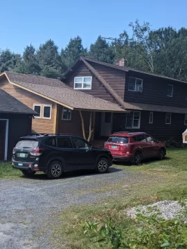

Is the addition taller than the main house? Can you post a picture of the chimney and rooftops of the main house in relation to the addition?

Yes, before recommending fixes, I'd like to ascertain if there are exterior influences creating positive pressure around the chimney cap.
Thanks for your replies. The new addition is lower than the main house. For the first year or two after building it, there was no problem with the draft. The addition is a new kitchen/dining area. Last year, we converted the old kitchen into a larger bath, mudroom, and laundry. That area, which represents 1/2 of that side of the house got tightened up with new windows, entry door, and insulation.
