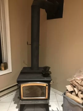

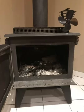

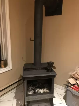

Can you post a picture or two of the fireplace? Is this a Franklin stove? What you are describing sounds like draft reversal. This can be very dangerous and life threatening. Is there a CO detector in the room?

Sure. I have used the fireplace a fair amount and this wasn't happening originally but only started more recently I've noticed.
I used to have issues with draft at the start of lighting a fire but I've managed to avoid that now but now after I think the cast iron cools it has a back draft I think. I do have a carbon monoxide detector in the room and a few others in the house.

Thanks for the pictures. This is a conventional wood stove installation. It's steel, not cast iron. Is it installed in a basement? If not, is the house very tightly sealed?

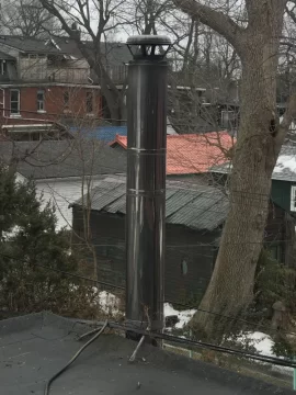

Put up some photos of the flue from outside the house too... I would not burn that stove until you get the reverse draft sorted out.
Are you sure your CO detectors work? I don't see how they could not be going off if the stove's full of coals and it's venting into the house.

This is the flue from the outside of the house. I had a chimney sweeper check it and clean it at the start of the season a few months ago in September. This problem wasn't really happening until a few weeks ago, or at least that's when i first noticed it will leak from around the door and the air vents in the side. Also I don't have a backdraft when the fire is burning, only after the stove goes out; is that normal?

How much have you burned this season? If your saying this is a new problem I would have it cleaned and inspected again before using it.. If you have a blockage in the pipe it could be causing this.
Given that it used to work and now it doesn't, and that the stove is in a leaky room, I am thinking that maybe you have very poor draft, not a draft reversal.
The cap's not plugged. It is possible that you either had very rapid creosote buildup in the flue (doubtful because you'd see lots of crud on the cap), or that you have a squirrel or a bird in there.
Also possible that whoever swept it last swept the vertical parts only, leaving a big pile of crud in the horizontal section?

My next step would be to look inside that horizontal section of pipe, and also inside the the flue collar on the stove. Look for anything that would restrict airflow (piles of sweepings, fried squirrels, etc).

Weak draft is definitely a possibility. The stove wants about 15' of flue. There are two right angle turns in this flue system which slows down flue gases and effectively reduces the height by about 4-6 ft. If the chimney outside is only ~12' then adding 3-4' of chimney with a brace at 5' above the roof edge brace and it should perform much better.
