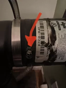

My cab50 was moved due to annaddition put on the house. The pipes to the wall have anbuilt-in clamp devoce, but now when I tighten them even to a spot where there is the least bit of compression to hold them together, they make a pop sound and are super loose again. I got some traditional pipe clamps on them, but i smelt smoke at startup. I read old threads and did what they read, got an LeD lightnon the area and i see smoke whisping from behind those screws. I replaced all rubber gaskets last year, cleaned the pipes well and was ready to put the black caulking that the installers used on the pipes, but this time fill around the screws and pipe seams.
Thoughts?

Thanks for the reply. Those arent sheet metal screws. Those are screws that tighten an internal-pipe clamp device, exactly like the one you see on the left that i added, but smaller.

Guys, no screws are going “into” the pipe. Look at this poc and u can see the built-in adjustable clamp that the pipe has per it’s design.

sounds like the clamps are stripped and no longer get tight, hard to tell from the pics but it looks like a standard hose clamp that goes in the channel on the pipe so maybe you could replace the clamps with a regular large clamp. Or the company that makes the pipe is Olympia give them a call and see if they sell just the clamps. Here is the phone number

After years as an Auto teck that is exactly what it sounds like
Tightens so far then slips on a tooth.
(overtightened)
Yeah, I've done that trying to make water pipe connections stop leaking in the pasture. That explains the popping sound he's hearing. Once you've done that, it's time for a new clamp.
Alternatively, you could get that as tight as you can get it without it popping, and then wrap Sharkbite tape over it. It's super stretchy, self adhesive, heat resistant up to 500 degrees, easy to cut off, and doesn't leave any sticky crap all over your pipe.

That is the appliance adapter. Most that use a clamp have a replaceable seal inside. Appears this part number has been discontinued, perhaps it does not have the internal seal? Use silicone sealer, then slide it back on.
Those clamps will over time, strip a slot in the band and this the result. It's around the thicker steel pipe exiting the stove, that pipe heats first, expands and the band clamp suffers. If you can, replace the band clamp itself or for temporary use, expand it and add a shim between the band clamp and the pipe. At least it will work a different slot in the band ... temporary fix.
Replaced the inside seals, works like a charm. Thank you though
