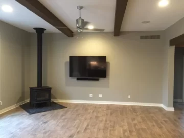

I've been burning with my PE Alderlea T6 for under one month. Yesterday after I loaded up my firebox after getting a nice fire going with kindling and a few small splits. I left the door open slightly and the air control wide own. I started to get smoke pushing out of the joints in my doublewall stove pipe. The room ceiling had a definite presence of smoke. I started to hear crackling and popping sounds from within the stovepipe about 7 feet above my stove. It lasted about 4 minutes and then stopped. It was awkwardly windy outside. The smoke however didn't push into the room out of the firebox, just from the pipe joint above. Stove temp had yet to reach 450°-500°. I burned the remainder of the day with no issues. This has never happened before. I was worried about a chimney (stovepipe) fire. I checked the attic and framed chimney area in the attic and found nothing obviously wrong and absolutely no smoke. Any suggestions or reasons why this may have happened? Thanks in advance.

You had smoke coming from the pipe and the popping and crackling sounds from within too? It sounded like perhaps something was burning at that particular spot within the stovepipe. My pipe runs 100% vertical.
