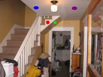

I reread my post, and did not understand it myself, so here is a pic
Easiest install is the red circle, but I'm concerned with it being a dead air space. The green circle would also be easy, but not sure of the airfolw around it affecting it. Then Blue - more wiring thru an upstairs closet, and purple is going to be hardest to wire.
The stove is in the LR to the right of the pic.
Any suggestions as the best location for an ion/photoelectric deterctor?

Where the blue dot is. Like you i would be concerned about lack of airflow in the red or green location.

Gotta go with Siege on this one . . . Blue or purple spots would be my preferences . . . with Blue being the first choice for the ease of installation factor. The red spot might be OK, but I'm not a big fan of detectors on walls since it will take just that much more smoke to build up on the ceiling and bank down before activating a wall mounted detector . . . plus if you want the earliest detection I'm guessing smoke coming from the room with the stove or from the room down the hall would come out of the doorway, creep along the hall ceiling and then go right up the stairwell without banking down enough to set off the red or green spots.

They will be interconnected units, but different config than mentioned earlier. Looking at Kidde Ion smoke/CO combo wired (talking actually) with a separate wired interconnected photo detector (not talking) that will activate the talking ion smokes. That will give me coverage on all three.
