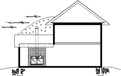

Daksy is correct, the chimney is within spec according to the manual, but it may be getting a downwind push. Is this a single story section of the house with a 2nd story next to it?
http://www.woodheat.org/wind-chimney.html
i tried to get an outside pic. dropped camera an d smashed it. not having a good day yet. picture a ranch with a second story 15 ft from the end. it is a salt box style home all open inside. very steep pitch on that section 12-4 on stove room. it has been windy while burning but not as bad as this a.m. i did notice a wood burning smell during a gust or two the other night. i thought it was coming from the soffit vents and leaking through recessed lights. the wind was from the north and it curls the snow off the back of roof. the chimney is 13 ft from the peak and 2 ft taller. a good 15-16 ft from other roof and also taller for the first 6-8 ft.

I think the turbulence by steep roof is big. Mine must be 45deg angle for my obstructing roof. Think that combined with marginal wood is giving me a lot of problems getting going from a cold start. I'll get a fire going with the door open no problem, close the door with air control full on, still going good, then trying to step it down I can hear the crosswinds sitting in front of the stove.
My situation is fairly ghetto, I think some of the 'scaffolding' holding the pipe up, combined with it being too short mine probably needs to be above the roofline... Just did a body measurement inside (thanks Michelangelo), 9' from side of pipe to centerline. Needs at least an extra three feet on top and the removal of kaput antenna, already has a wind cap on it (two rings)... To make minimums in my case.
