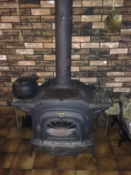

I have an old Resolute, Vermont Castings. Had since before 1985. Never had any problems. I didn't use it last year. This year I had the chimney cleaned, replaced gasket around griddle, bought seasoned, split oak, and got ready to use. Put in paper, kindling and some small pieces of wood to get the fire going. Smoke poured out of the closed door and griddle. Damper is open, hole on side is open, door is closed tight. Had Chimney guy come out and all he says is to buy a new stove. Can anyone help me? Do Cast iron stoves go bad? Hasn't been used that much. Any suggestions as to what I can try? Chimney is suppose to be clean. My pipe is straight up through the attic. One story rancher.

Stove pipe is a straight shot from stove to roof. I tried to take a picture looking up, but it's night time right now. I'll try again in the am, but this is what I got right now.
[Hearth.com] Smoke in room Doesn't look like I just had a chimney sweep clean it does it.

Want to thank you all for your responses. Had a friend go up to clean out pipe, couldn't get the brush all the way down. We came inside and he used a snake to see if he could get it up the chimney. He hit a thick block of creosote. He pushed and poked and chunks fell down. All of a sudden we could see daylight and feel cool air. Surprise! Then he went back up on roof and cleaned the pipe with the brush. Now we can look down the shinny, clean, creosote free pipe. Wood stove works very well, no smoke in the room. So much for my "40 years of experience" chimney sweep . The chimney sweep and safety inspection were usless. Can't believe the owner came out and told me the vermont castings was too old to use and I should buy a new one from him. Thanks again to everyone who helped with their thoughts.
