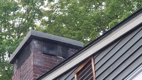

Hi everyone.
We have a smokey basement from our oil furnace flue and our wood fireplace flue meeting at the exit point. Unfortunately, there is a cement cap above the two flues. We did have a mason build a wall between the two, but it hasn't eliminated the smoke. What is the next-best solution? Should I wall off the sides of one of them so that smoke only goes out (or air only comes in) from one side? This seems like it would reduce, but not eliminate the problem.
While the smell is annoying, is it dangerous?
Picture shows a side of the chimney with the brick wall dividing the two flues in the middle. I hope I am using the right terms.

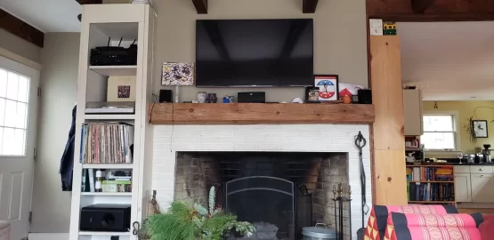

2. No vents. The fireplace and chimney are in the center of the house. In my mind, a large PVC pipe running from an exterior wall could serve this function, but it would be difficult and ugly as hell unless it came up from the basement. See photo to get a sense of the room. There is a room behind the fireplace as well.

I think trying to get combustion air thru the clean out in the basement would exacerbate the situation. You need OUTSIDE air…

I've seen various people here deal with a chimney like that several different ways...pop the top off and have a mason make it so they are different heights...or I think I recall someone having a hole cut in the stone cap and put an extension on the top of that flue
