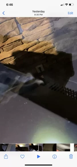

regardless of the culprit, how is it that in a sealed box with no smoke coming out of the front of the stove that I had smoke visibly spilling out of the back of my stove? The stove was exiting out the back seemingly adjacent to the rear box enclosing the by a metallic valve air intake. I took a video of this. Initially a lot of smoke spilled out but as the stove was heating up less smoke was coming out but I was able to capture this.
Any ideas on where I should look? any ideas on why smoke would be able to exit the rear of the stove. The stove has not been moved, bumped, or anything along those lines. It does have a cold air intake which is running from the crawl space of the house.

I attached a photo of the smoke out the back. I couldnt tell where it was coming from.

If your stove is backing up and unable to exhaust smoke it can back up into the intake system. Even though you have an oak connection that intake system contains loose fitting connections. The curved hood over the thermostat is a loose fit, the oak plate near the bottom is a loose fit. Yes, the flue connection can be quite leaky too if your chosen pipe is a poor fit. The only other openings are the loading door and ash plug. I suppose a small leak is possible where the cat meter probe enters the stove too.
