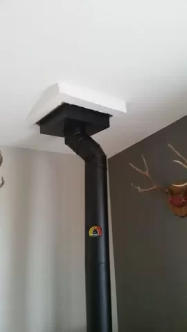

There arent any 90 degree turns, but just before the chimney goes through the ceiling there are 2 approximately 135 degree turns. In order to center the stove we had to adjust the pipe a bit. So theresbout 5 foot of pipe until it hits the ceiling, and id say about 7 to 10 foot that comes out of the roof. Does that make sense?

Two 135-deg turns...could you possibly post a photo of the installation showing these turns. That could be a problem.

You may need to add a length or two of pipe. However, I'd still like to see the photo of those 135-deg. turns.

I may be completely off on the actual degree of turn, this is what they look like. :)

That's a pair of 45's used for an offset. We have the same offset that had to go in when we replaced the stove, but with 20ft total flue. What is the outside temp?
