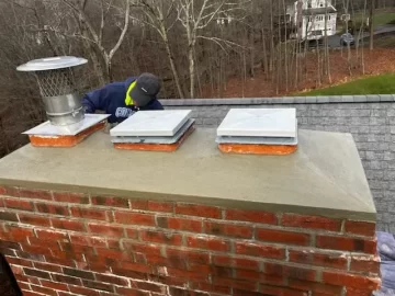

Hello I have a similar problem one chimney with 3 separate flues servicing 3 separate chimneys 1. Basement, 2. Main floor and 3. Master bedroom. I had the main floor chimney scoped and of course the flue tiles were compromised so I had it lined and had an insert installed. Seemed to solve the smoke in the basement issue until tonight. The other 2 flues have caps on the top - dampers and we keep them closed so not quite sure how basement started to smell? We do have a dryer on the main floor - not the basement and it was running this evening so not sure if that had anything to do with it. Nevertheless I can’t understand if the other 2 flues are closed with top cap dampers and a liner in the useable fireplace smoke could still get pulled into the basement. ? Adding a pic - as you will see I also had the crown re done as well beautifuly !
