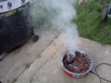

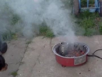

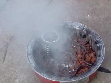

This is what i have come up with and have been testing it for the last 5 hours. 12oz coffee can. Drill three 1/4 inch holes in bottom in a triangular configuration. Drill one 1/2" hole near the bottom of can, on the side of it. Fill can with water soaked wood chunks. I started the burn on my gas grill, just placed the can on the side burner until lit. It flamed but I blew it out, and it smolder smoked for half hour, then the chunks ignited to flame. I threw some more water soaked chunks on top, put the flame out and still having a hot coal in the can. I just filled the can to the top after a few flare ups. It flares after an hour or two, maybe a tin foil cover would help? Put in some green jalepenos to experiment with, along with the coffee can smoke generator. Real chipotle requires vine ripened jalepeno smoked in pecan. I'm using mulberry, it's what I have
If you cover the can with foil and poke some holes in the top that should keep it from flaming up...and it will smoke a lot longer. You may need to add some holes to the bottom of your can to give it enough air to keep on smoldering.

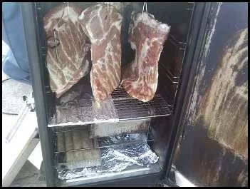

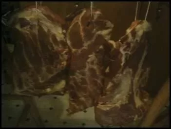

I cure and smoke bacon as well as sausage. The best way I have found is using Todds amazen smoker. fill it up with dust and it burns for hours. Gives you a nice even smoke, and once the bacon is dry and the pellicle forms, the smoke sticks nicely. I am a member at the smokingmeatforum, and a lot of members have this and love it! Before I found this I used a can and what a pain in the butt it was!

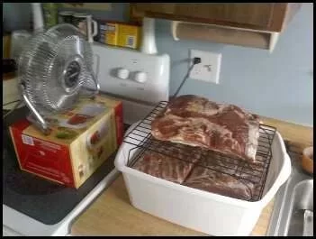

How long does it take to get a pellicle? After 7 days, I took the bacon out of the ziplock bag, rinsed it and soaked it for 2 hours. Pat dry and let it sit in the fridge all day, about 12 hours now. I dont see anything . Is a pellicle visible, or you just know it's there after a day in the fridge?
I went over to the fourm to see if I could find a good post for you to read! I found this thread which should really help you out!. When I was getting the pellicle to form on bacon before I smoked it, I just sat it in front of a fan for 2 to 3 hours! After 12 hours sitting in the fridge you should be fine to go ahead and smoke it, All your doing is drying out the surface of the bacon, so the smoke will stick better to the bacon!

Bacon is done. I used the coffee can and apple chips for a cold smoke. It came out too smoky. My first time. I had the smoke going like the pics above. I read on the smokingmeatforum, you really don't need that much, just a light wisp of smoke.
Yup TBS, thin blue smoke, if it is pouring out like a house on fire thick and white, this is no good! But hey it is your first try, you will get it!
