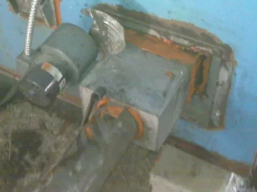

Hi, I bought a used coal stoker only name on it is on the door (Hardin). There is no name plate anywhere on it. Anyway im getting smoke back side of draft blower into coal bin(using 55 gallon barrel as was previous owner) New chimeney , no damper in pipe. have shut blower down as low as i can still back smoke. Getting large amount of clinkers also.

Thank you, im on there too. Im not having much luck there but i have stopped the smoke with sealing the bin
