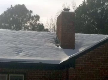

Does the snow around your chimney melt faster than it does on the rest of the roof?
If it does, does it mean that your house or roof isn't well-insulated, or is that to be expected?
I do notice that ours does melt faster near the chimney. It's an interior chimney, and I don't have a blockoff plate. It's also a 60 yr old masonry house and IS lacking in insulation (in the roof and elsewhere.)
It's a good masonry chimney, and we use an insulated flex liner, so I am not worried about safety. Efficiency concerns me a little, but I know there's a LOT of stuff we can/should do to make the house tighter overall.
This shows the approx 3" of snow, melted on the flashing on the east side of chimney today.

Not necessarily. Most building codes require a three inch clearance for combustibles to be kept away from the chimney; framing, insulation, etc. About the only thing you can do is to cover the gam between framing and the chimney with some silicone and flashing to limit air movement/penetration.
Also realize that the brick absorbes heat and radiates it back out which will cause some melt. The outside flashing can also reflect sun and melt snow in specific spots too.
