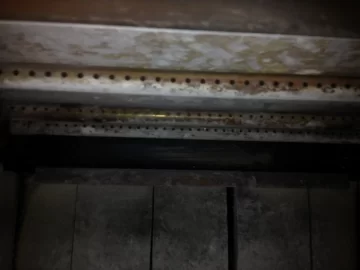

I burn nothing but hardwood. I try to stay in the range of 400-500 degrees. Worried about going over 550 because I have gone through a chimney fire once with regular fireplace. Ive been told it is safe to burn at 600? Also, just yesterday had it cleaned. I was told I could go 6 cords now that I see the amount of creason (sp) that cam out I know I was pushing it. I am now getting it cleaned every 2-2.5 cords. when the chimney was cleaned yesterday I took a look at the tubes after he left and noticed the front tube, holes faced towards the door. Middle tube, holes towards back and back tube, holes faced towards door. Call the prof cleaner and he said it didn't matter. I went ahead and changed the middle tube back to facing the door (forward) this morning. My question is does it matter what direction it faces. Also how hot can I burn this and feel safe. A Chimney fire experience makes you rattled. Before I would damper down at 500 and burn an hour before another load and repeat process. Also as a side note the way I prepare the fire before I go to bed.. Throw a good piece of wood when at 450-500, flare it up for a few then damper all the way down. Any suggestions?

Agree with BG on the temps for sure. And, from what you say you are not running hot enough if you are producing that much creosote. Try that 550 for a while. I would also check w/VC but the tubes should face the output of the stove so the draft is pulling air through them.

will do. Yea the amount of Creosote was concerning. It filled up a normal size ash pale. That was 6 cords worth. Like I said now going to clean at 2-2.5 cords. As far as tubes I just put it back to the way the picture shows in the manual.

I'm confused by the mention of tubes in the stove. Which VC model is this, the Savannah? If so you are correct, the secondary tube holes face forward and the recommended temp range is 500-700::F.

I'm confused by the mention of tubes in the stove. Which VC model is this, the Savannah? If so you are correct, the holes face forward.

middle was facing other way. I corrected it.
