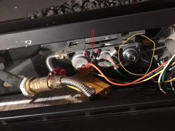

Can you post a pic of the gas valve?
This is the best picture I can find at the moment. Unfortunately, it does not show the ADJ screw clearly. It is one of the screws as marked by the arrow.
The circle in yellow is NOT about the ADJ screw position. That is for another question I asked someone else a while ago.
