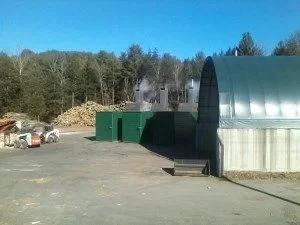

Below is a very poor cellphone photo of 2 of 7 kilns at Treehugger Farms in Westmorland NH. The owner claims he's shipping 60 cords per day. The advantage of kiln dried firewood is that they can ship across state and county lines since it is assumed that the bugs are cooked (medium rare).
He started out with his first kiln using a Wood Gun burning the sawdust but it didn't work out for him so he went with hot air furnaces using regular firewood. This place is really steaming on those below zero mornings.
Sorry I couldn't get a better photo but I was gumming up traffic and had to move.
