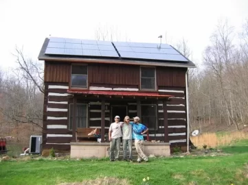

After three days of work, the PV system is installed, connected to the grid, and producing power. This is a 4000 watt grid-tied system, estimated to produce an average 400 kWh/month. The system was installed using State of Ohio grant money combined with the remainder financed by my wife and I.
24 X Sharp 167 Watt panels and Sunny Boy 4000 Watt inverter.
Installation by Dovetail Solar and Wind. I had wanted to do this myself, but in order to be eligible for the state grant money, it had to be done by a certified installer (which I am not!).

Unfortunately, the state discontinued the program as of (I believe) March 4. I got in just in time. By the way, the three amigos in the picture are of the guys who did the installation. The other dude, Drake, is the electrician. He just moved here from Colorado.

483 kWh after four weeks of production (exactly 28 days). I have seen a high of 28 kWh in one day, and a low of 9 kWh in one day. We have had some pretty cloudy skies lately, so I'm curious what those consecutive long, sunny summer days will bring. I'm hoping for a high monthly production of 650+ kWh (average 21 kWh/day).
Here's another picture, highliting the glory of the panels...we are currently about 100 kWh "in the bank" for this period.

That would almost completely get me off the grid...my highest bills are rarely over 600kwh, normally under 450 in the spring and fall (when we're not running the heat or cooling).
I like the fact that you basicaly just covered one whole side of the roof, looks alot cleaner that way. Do you have a cleaning and maintenance schedule? I've always thought that a well applied coat of Rain-X or similar product would be a good idea for solar panels to trya nd keep them as clear as possible.
I asked the same question to the "expert". No maintenance. Just let it hum through the days. I suppose a little pollin or dust might affect efficiency in the fraction of a percent range, but not enough for me to risk my life. The rain seems to do a good enough job.
