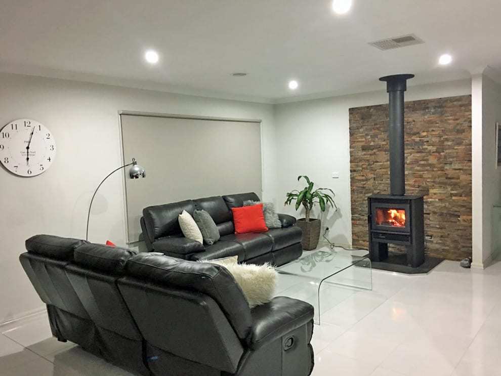

Hi
I had a neo 1.6 free standing installed early last year. I wasn’t very impressed with the heat output during last winter.
My house is 135m2 or 14.5 squares and the heater is rated for 250m2. But after it burning for 5+hours I am lucky to get a 4*c increase in temperature in the lounge room it is in, and maybe a 2*c increase in the furthest part of the house.
House Has good ceiling insulation
Only has insulation in top half of walls. I installed this myself pushing batts through the brick cavity from above, but could not get passed the noggin in the middle of the wall.
Timber floor boards.
Standard single glazed windows.
I am wondering if changing the current solid flue to a decorative flue would make much difference.
I would appreciate any advice

Thanks for the quick replies.
The heater is rated to 250m2 on Australian websites... not sure why the big difference but I do remember there being a different in m2 and burn time... I asked both my local website and pacific energy about the burn time, my guy saying it’s because in Australia we have much better wood to burn... pacific energy kind of agreed but couldn’t be sure.
I didn’t question m2 with pacific energy.
room temp is around 15-18*c when I light the fire

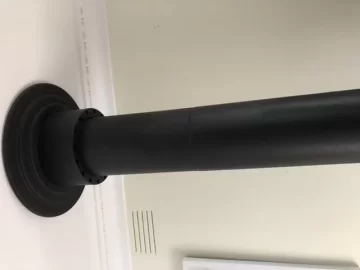

by decorative flue I mean the outer skin that is seen within the house has many small holes which allows radiant heat to transfer from the inner skin flue into the room. With the solid skin(no holes) I currently have I am thinking a lot of heat would be trapped inside that solid skin, not getting direct radiant heat from the inner flue into the room.
I did get a quote on getting blow in wall insulation but it was 4 times the price of getting the ceiling done well with oversized batts.
Wood is stored in a shed. Most of it is sitting in there for a year. When I questioned my supplier about not being happy with the output he said to make sure the wood is at around 15% moister content.... not too dry. I did check my wood once last year and it was at 17%
I mainly burn redgum 100mmx100mmx450mm stumps from old house stumps or fence posts. I do have some split logs but I can’t recall what type of tree. Yellow box maybe... some type of hardwood. Once it’s burning hot I leave the vent barley open and overnight I leave it shut.

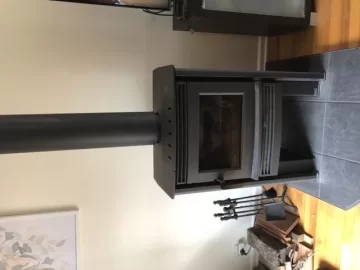

I did check the wood heater temperature over the weekend. The top was at around 45c.
I also Stuck my thermometer inside the vent to touch the next layer of metal down where the fan flows air out and it was 53c
Here’s an Australian website showing the 250m2 and 12+hour burn time. I did my research and this wasn’t the only Australian website stating this.
I was hoping swapping to the decorative flue with many holes would give out some more heat. You said it causes creosote issues. It wouldnt bother me if I had to get the flue cleaned once a year instead of every second year. Or is it a bigger issue than that? Obviously don’t want a flue fire.
while doing a bit of research on this problem I have seen flue heat exchangers that branch the flue into 2 or 3 flues within the room, making more surface area of flue I guess.
But they don’t look great.

I forgot that the top of the Neo is totally convective, still the temps reported sound quite low. How are they being measured? Do you have an IR thermometer? If so, can you remove the upper grille temporarily and get a reading on the actual stove top?
Note that the 250 sq mtr heating claim is being made by a stove sales company, not PE. This is marketing.
I used a digital meat thermometer.
I poked it through the grill to get the 54c
And the 45c was next to the grill.
Both touching the metal
I do run the fire with the air vent between 1/4 and closed to save burning through wood quickly. I only have it all the way open for the first hour to light it and build up coals.
Once I did try running it at 3/4 open for the hole day and it might have made a 1 or 2c better difference than vent at 1/4.
Try turning down the air sooner if the wood is burning well. If the draft is good, then after 10-15 minutes the air can be turned down at least 50%, or until the flames get lazy. Then wait for the fire to recover strength for 5-10 minutes and turn down the air again to 25%. That will encourage a hotter secondary burn. The temp reading method is not accurate. The stovetop is more likely around 260ºC, unless something is wrong.
