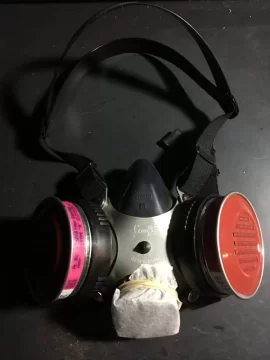

I cut up an old N95 mask and put it over the exhale valve to protect others. I don’t see how many liquid particles could get out of the check valve and cover, but if anyone knows what they’re looking at they know a respirator only protects the wearer. Maybe they’ll realize I’m protecting them too. Ordered 20 of the particle only P100 filters when this started instead of the harder to breath through Multigas cartridges I had. Much better for long duration wearing. My glasses fog, so I don’t like surgical type masks. MSA Comfo half face.

As far as I know, the official word is still that this virus is only transmitted by liquid droplet or contact, it cannot be aerosolized. You cannot catch it by breathing the air near an infected person, unless they sneeze or cough, putting liquid droplets onto you.
Masks are great when put on the infected person, for protecting others from any droplets they may be spraying when they cough or sneeze. When worn by healthy patients, they mostly just serve the purpose of keeping you from touching your face, or that rare scenario where someone sneezes or coughs right on your nose and mouth but somehow miraculously misses your eyes.
The no-valve masks are likely better than valve masks, in this application, as we all know the valves on most cheap masks leak liquid. If worn by a sick person, they may still pass water vapor and even drip on occasion.
I agree that the exhale valve makes these types of masks a personal protection device and not a device to protect other people from you. This is because you exhale unfiltered air. Maybe it depends on why you’re wearing a mask.

I've read plenty and heard virologist say that it can absolutely aerosolize. Most doctors not associated with the CDC are saying all persons should have a mask on if they go out. The virus can only enter your body through mucosal membranes.
