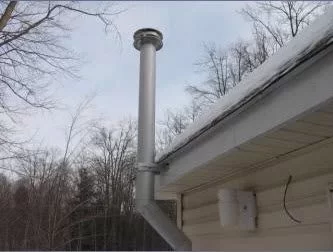

The only difficult thing to do to correct your venting set up would be to replace that 90 horizontal 90 setup with a 45 straight (custom cut) 45 reversed to the final vertical you already have.
You were so close that a simple increase in the rise of that horizontal section did the trick.

You don't make any 45 degree cuts it is a standard 45 degree piece of vent pipe, followed by a straight piece (which may have to be custom cut) followed by another 45 degree, the object of this is to get an 3 foot offset to enable you to get rid of those 90 degree bends. Is it a must no it isn't it is but one way of correcting your vent set up which you have described as having a 90 3 foot horizontal 90 configuration without cutting another hole in your roof. This would put a set up like poconoman had on the outside of his place.
It would look like this:
_____|_______ roof
instead of
Code:
_________|________ roof
_________|
These both provide an offset the first one using 45 degree bends and no horizontal run (the offset EVL is about 7.5 ) and the second with the 90 degree bends and a horizontal run (offset EVL is 13).

........hey Smokey.....you mean 2 - 45's like this?...... (thanks poconoman for the pic!) ........ cc :-)
  • [Hearth.com] Some Questions For The Experts
Yeppers, CC, exactly like that I even mentioned poconomans post as an example back further in the thread.
