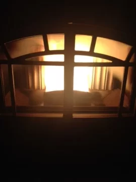

I know a proper burning fire is very important. I would say I have far from a lazy flame, and not one that looks like a torch either. My measured draft is perfect, but when running on the highest setting, 5, I do get one large swirl of smoke on the left side of the firebox, that is promptly evacuated by the exhaust and out.
I assume this is normal, given the size of the fire and the HOT cubex pellets. This thing roars on 5, so I don't see how you could not have any smoke in there. Even the fire itself reaches the top of the inside, and rolls off to both sides. Just checking with those that know more than me. Here's a picture, although it's hard to see the smoke on the left, but you can easily see the fire quality.
Thanks! [Hearth.com] Some smoke in stove is normal right?
As long as you don't have smoke in the house, I wouldn't worry about it.

Interesting posts, thanks guys. I find that on setting 4, a step down, the flame just barely touched the top, but the output is reduced enough that the stove can't always keep up when the temps are colder. So there is definitely an increase in heat output when on 5. But I certainly don't want to overfire or warp anything, but I would think, since I've done nothing unusual to get it like this, that if it was that easy to do and cause a problem, that a lot of people would be having a problem. I would like to find a video of ire size on setting 5. I'll have to check out the enviro videos.
Now this is weird. I just looked over and saw the side of the stove just to the left of the back plate with glowing embers. Not sure what was going on I shut the stove off. It looks like embers burning on the back. And I noticed the sides are black ash. It's not thick or anything but black.I just lightly rubbed it and you can see the path the scraper left. Came off like nothing. This pic kind of shows it. I'll clean the stove good this morning but given good draft and flame am I having some other issue? Or is it ok to see some glowing stuff settling here and there?
