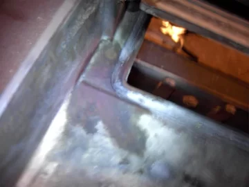

For the past year, I have been talking on this forum about how fragile DW stoves are but I did't think it would go this far or this soon. You can't really see in my picture (cheap camera) but I have 2 cracks in the damper shelf (one on each corner) visable from the top of the shelf. I'm no welder, but I don't believe that cast can be repaired. I was hoping to get a couple more years out of this stove before I sold it but now it is useless. It a good thing I put an insert in this year. Terrible stove.

Yet just one more excuse why this is it for me. This stove has made my wife think im crazy. Looking forward to getting a blaze king. Good luck to those of you that have this stove.
Over fire any stove many times as Im pretty sure thats what has been done to this stove and you will get similar results.
To many people having problems with this stove is just one way to say that it may have been because of over firing. Who knows. There is definitely something wrong in the design of this frekin thing for all the problems people have been having. especially when people who have been burning for many years and still have problems. i've been able to get this stove to work work correctly but it takes 20 to 45 minutes of babysitting after dampering down to do so. something just isnt right. nor do i have the patience anymore which is why i shut it down completely. waiting till next year to get the blazeking. Now my wood supply will be 3 years split and dried which is perfect for the blaze king. i won't even feel somewhat sad to see this thing go. It's put me thru hell.

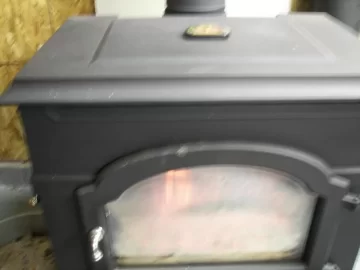

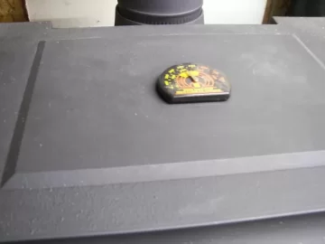

Im getting tired of these DW bashing threads. At 3:30 this after noon, (its now 6:30 in michigan) I put 3 splits as everyone calls them, I grabbed the camera and here is what I have 500 stove top. and still a good secondary burn. The 1500 ft shop is 74, was 66 and after the last load at 6 am. You guys got something screwed up in your system, because Ive never got anything but outstanding service from mine.

heres the other photo

I'm not sure what created the cracks in my stove but I know I never overfire the stove if you consider an overfire as glowing cast iron. I may have gotten the stove hotter than I would like at times, but that was due to the stove running away when I was home. The big question is did it ever go into hyperfire when I wasn't home???
I do know that when I compare my operating procedures to others on this site (some w/ videos) I didn't run my stove nearly as hot as the others. I did use this stove as my only heat source for 4 years in a 1400 sq ft. house. I don't know if others posted here are doing the same. I'm sure others are checking their stoves as closely as I am (I hope). My 1 year old fountain has a crack between the two exit passage ways and the front seam is separating as well. Is anyone else finding pieces of the fountain on top of the shoe?? That's the first sign of failure. I'd like to know why or what is causing these failures. I was considering the possibility that the cracks in the damper shelf could have been aided by the damper slamming shut at times. I gently close the damper but on occasion when I was cleaning or reloading I'd bump the damper and cause it to slam.
The bottom line (for me) is that as a new wood burner purchasing my first stove 4 years ago I was not given any warning or real direction in operating the stove from the dealer or from VC through their operating manual (my manual even neglected to warn about using caution when cleaning the flue due to the fountain...this was changed in later manuals). I used a magnetic thermometer to guide me. If this stove required special operating procedures (it does) and contained fragile parts (it does ....fountain, shoe all refractory materials) why didn't VC or the dealer warn me. Even if my operating procedures are incorrect (I doubt it) and I replace all the failed parts I will have more money in this than the original cost of the stove since the company screwed me out of my warranty. If I don't scrap this stove I will sell it for parts only and walk away and try not to think about my loss. I just hope down the road that we don't find that the design of ALL EPA stoves are such that they burn hotter than what the fireboxes can handle for years and years of use. I know old pre EPA wood burners that are still running after 20+ years w/o problems but there is another post on this site w/ concerns over PE EPA inserts cracking. A stove that I just purchased this year. Are we sacrificing reliability for emissions??? I hope we can have both.

My stove ran great just not reliable. Eco's not falling apart but burns terrible. If your stove runs so well and has not disintegrated like mine, give everyone more info/pictures. What are your flue temps about 18" up on the pipe? Show use the install. Give us some picture of secondary burn etc.

the photo above is secondary. i thought I explained that. anyway I will take some other photos for you
